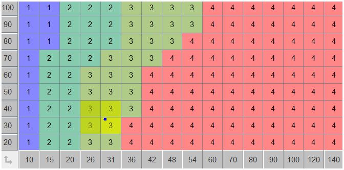

2) I don't see any activity at 200 seconds into your log. At 255 seconds there is a 4-3 downshift (and the TCC unlocks). At that time the vehicle is going about 53.2 mph and the load is approx. 68.5. You are very close to a 4-3 boundary in your table. Your target gear drops from 4 to 3, and the current gear follows a second later. You can probably fix this behavior in the shift table. Your current table is:
And you might try changing it to:

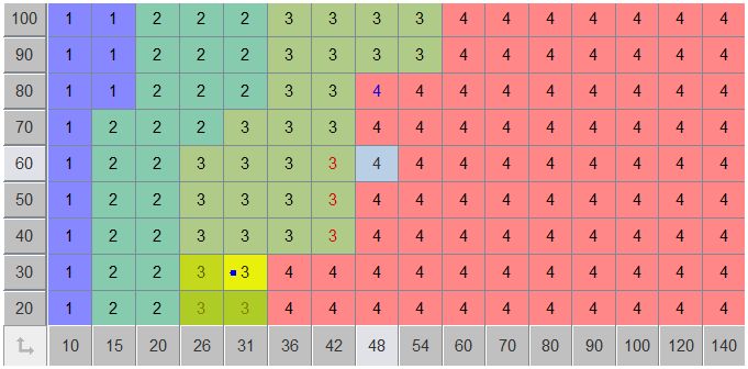

This makes the shift a function of speed on in that area of the table, so that you aren't bouncing the target gear from 4 to 3 to 4 regardless of changes in the load, etc..
