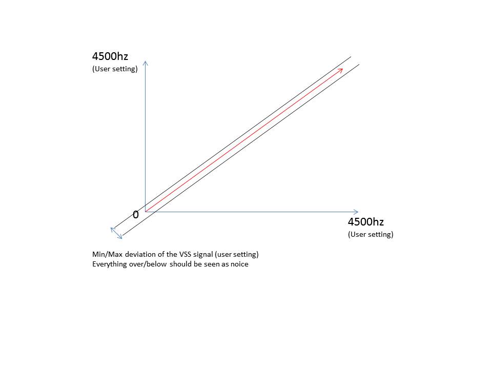

In my head the logic tells me that there is only a certain speed increase over time that should be seen as valid speed so not sure how it or if it could be done or if my logic is that logic :-)
Now in theory this will not filter anything since X and Y will see same signal and noice
This could be worked around if X and Y have different sampling rates so they never look at
the signal at the exact same time, this might however not be possible to do within the code?
VSS filter.jpg (26.21 KiB) Viewed 17091 times

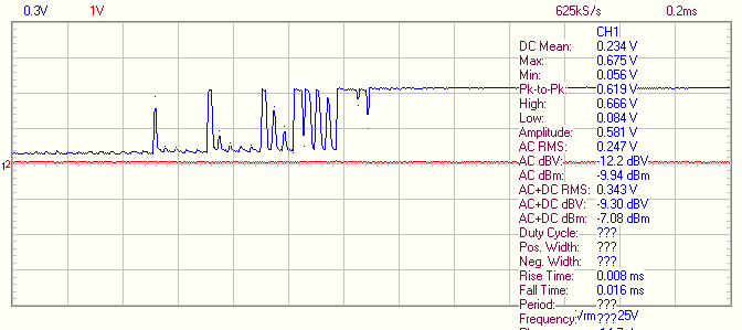

Wired up everything on the bench again now with a new signal generator....
Found this at a closer look of the signal at VR1 at the 25pin header, 50hz sine wave out from the signal generator and ppv 8v
I guess that the processor doesnt like this, speedo in TS showing max speed....
So it seems to be hardware after all...

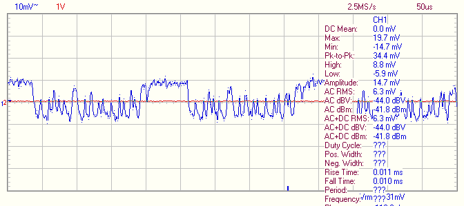

Some more scope shots.
Noice in the 5v supply (internal GPIO)
5v supply.png (11.15 KiB) Viewed 17053 times

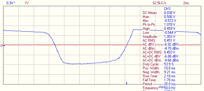

signal at R43 at 50hz
50hz at R43.png (9 KiB) Viewed 17053 times

Well spotted! I strongly suspect those oscillations are the source of the problem. The most interesting place to scope would be the base of Q13 (the transistor's middle pin), as this is the intermediate stage in turning the AC signal intro a square wave. (Nevermind, that's what your R43 shot is showing)
For the power supply, if the divisions on the blue trace are 10mV, then the variation (34mV peak-peak, 6.3mV RMS) is fine. It's a bit hard to tell though, since the absolute level isn't specified (it looks like the screen shot has AC settings displayed).
If this was mine, I would probably:
- check the VR1 circuit very, very carefully , and touch up any joints that didn't look perfect (and maybe touch up ALL of the VR solder joints just to make sure),
- I would inspect the two transistors (Q13,Q14) very, very carefully to make sure the soldering is perfect and there is no bridging or residual solder flux anywhere at all,
- if that didn't help, I might try building up another of the VR circuits (if any are available) with new components and jumpering the new circuit to use as the VSS as it's not impossible some of the components are defective or have been damaged by static or heat,
- finally, if none of that helped, I might replace R42 and R43 (both 33K) with 10K resistors to make sure that the transistors could turn on and off quickly.

I actually just stumbled over this, if I masure the VR1 signal at the 25 pin header and just hit the auto scale function on the scope it will display a perfect square wave.
What I noticed was that I didnt get any frequency reading in the wave form parameters, thats when I changed the time line to strech out the wave....
Actually the raising edge is looking the same as the falling.
As usual I forget to switch over to DC as I did checking the 5v supply.
