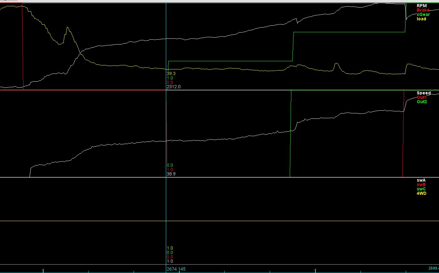

Right... some progress.
I noticed that my speed was stuck at 5mph with the sensor disconnected. Couldn't find any faults so I removed the DRAC and connected directly back to the VSS and now have a better speed signal. Perhaps there was an issue with the way my DRAC was installed.
Now have better speed signal and I can run the VSS as I should with the correct number of teeth etc.
But I still have a couple of problems
1. The transmission starts in second gear in every lever position other than 1, when it will shift down to 1st. I can't see anything wrong in the datalog that could cause this? You can see that there is no RPM or speed change when the transmission shifts from 1st to second in the datalog.
2. Why does it take so long for the transmission to shift when the table says it should be in a higher gear? I've tried changing the shift factors, but it hasn't made any difference.
Could someone please help by taking a look at the datalogs and MSQ attached?
Thanks
Sera
2016-04-23_10.38.52.msl
(114.59 KiB) Downloaded 1280 times
shift2016-04-23_10.57.39.msq
(243.54 KiB) Downloaded 1502 times
Re: Help with 4L80E
Sera,

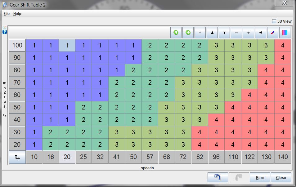

In your datalog, as in the previous one, the shifts (cGear) immediately follow the change in the target gear (tGear). So you may be asking why the target gear isn't changing. That may be because of a few things, but one possibility is that you are not using the shift table you think you are. There are two shift target gear tables, and which one is in use is determined by the state of the input on PE1/GPI1/Amp5.
That could also cause the 2nd gear starts, as could having the 'follow mode set to an inappropriate value: http://www.msgpio.com/manuals/mshift/V5tune.html#gs
flak monkey
Posts: 50
Joined: Sun Sep 21, 2014 11:28 am
Re: Help with 4L80E
Post by flak monkey »
Thank you :)
It does indeed look like its defaulting to use shift table 2, rather than table 1. The 2wd/4wd is floating at the moment, I had intended to use it to provide a 'Sport' mode via a toggle switch. Looks like it works opposite to what I thought. Presumably if I ground this wire it will switch to using table 1?
The shift points in this table seem to match those in my log... better than table 1
table 2.JPG (95.93 KiB) Viewed 37182 times
However they still don't match perfectly with table 2, according to the log I have shifts at:
1-2 39mph
2-3 49mph
3-4 75mph
Only the 2-3 and 3-4 ones make sense. The 1-2 shift should have been at 16mph?
But if you shift the lever into 1st it does shift down and stay in gear.
