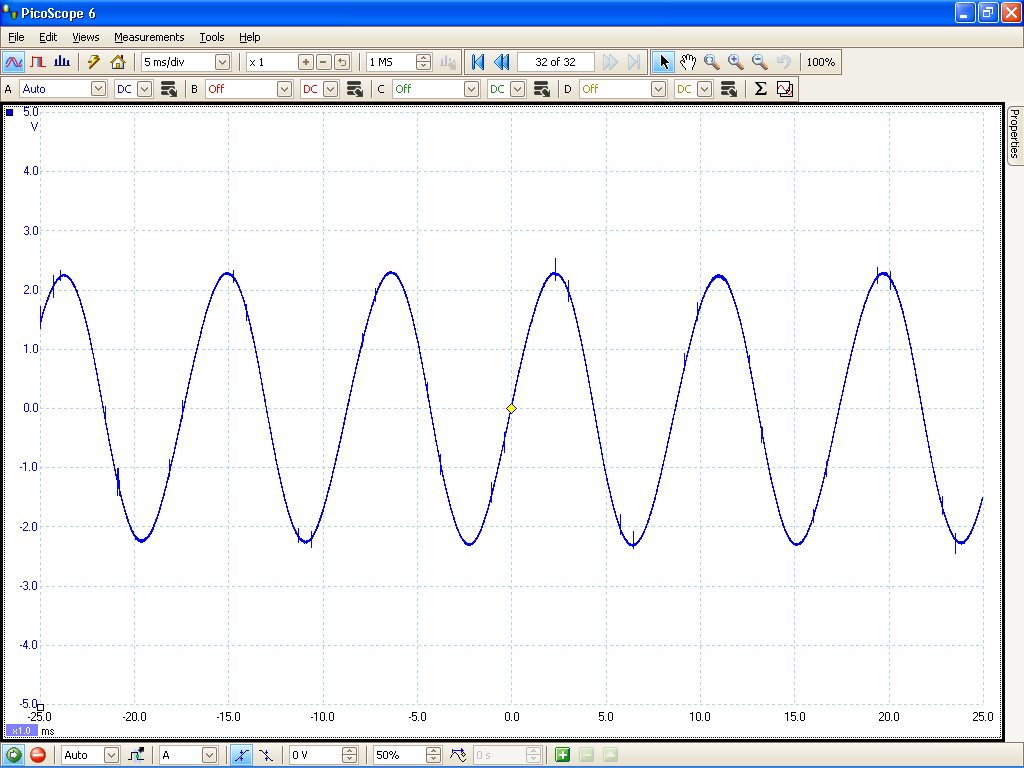

FWIW, here is a scope trace of the VSS input to GPIO with rear wheels raised, transmission in N, engine running and the wheels turning ever so slowly on their own.

I loaded your msq and rebooted MShift, and with a VSS input of 1606 Hz I got a speed of 100 kph which seems about right. The speedo is smooth and responsive to changes in the input frequency over a wide range. I have been unable to provoke any other displayed speeds at that input frequency, but I will keep trying.
One thing that will screw up the speedo is an intermittent signal (i.e. a single that drops out completely) as this interferes with the masking and can lead to multiples of singles being dropped once the signal is restored. However, I can only accomplish this on my bench by changing the signal by 10x instantaneously. I suppose this could happen in a vehicle if the wiring connections (or the VSS circuit build) were not perfect. Since you had trouble with the VSS when using the stim, you might want to check that your VSS circuit is correctly configured.

What you should be looking at is actualy the signal AFTER the VR conditioner going into the processor pin.
Its easily accesible on the header.
I assume you have alot of logs so look at them and look at the VSS signal there, most likly it jumping all over the place.
I also learned that a clean VSS signal from the sensor wont solve all problems, I had to use another VR conditioner to sort it out!
Drawing is avalible here on the forum just search on "tobmag"
My XJS is extremly noicy in the whole electric system so I needed to add some filters on the positive feed lines as well as it also affected the VSS!

Right, Ive got speed sensing sorted. I've got a TP500 module doing the conversion from the sinusoidal VSSensor output to 12V square wave which is then fed to GPIO as well as the VDO speedo gauge:
When the speedo still went haywire above 50km/h, I realised that something was wrong with the TP500 setup and that is when a friend of mine raised the possibility of the TP500 saturating.
I think I had 2 main problems:
1) my TP500 module saturated above 50km/h. The input signal voltage became too large for it and it stopped became erratic. The 220Ohm resistor between the two wires loads the sensor output and reduces the output level of the sensor keeping it to a level that the TP500 can cope with.
2) I might have had a dry joint on R45 - hard to tell though with all the component replacing that I was doing.
I modified the VR1 input circuit to be more suitable for a square wave, but now that I found the TP500 issue, I'm not sure if the mod was needed at all.
